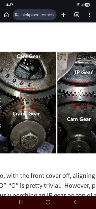

Which engines have the timing marks on the camshaft gear like in the picture on the left? My understanding was that the mark on the camshaft that is supposed to align with the crankshaft gear was also a dimple like on the crankshaft gear, not a stamped "O". If my camshaft gear has the stamped "O" and not the dimple then I can see how similar it is to the Y mark and can could be mistaken for it if using the feeling with a pick method. I am going to take the injection pump cover and inspect it closer. Ill figure out a way to actually see the y mark with my eyes instead of just feeling for it.

4,447
5,059
I can't remember how I did it........I distinctly remember it being very difficult, though. Good luck, Senor! Keep us posted!
