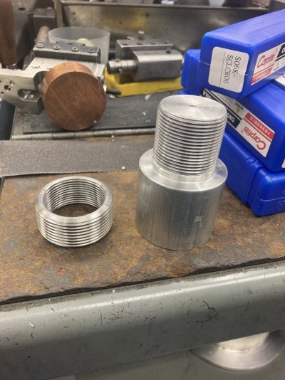

Do you not have a shroud? That'll make a big difference too. Nice work! How'd you get the adapter? It's a nice peice.
Yes there is a shroud. If you go back a few posts, you’ll see it. I just left the top off to watch and make sure it’s running true.
As for the bushing, I drew it up and had it machined so now I have a CAD model.
Soooo... How much ?? PayPal ready :)

@homelessduck
I’ve considered having them made once I have enough test mileage to feel good about it. If there is interest, I would consider it. Unfortunately, the prototype places that do small runs have gotten really pricey of late. From the use I first got one 3D printed for fit check till I had the steel parts made the price more than doubled. I was unhappy.
