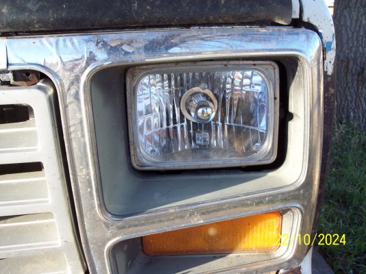

@03wr250f what's in your pics is what I'm looking for. Nice clean cutoff, nice bright light. Are those the aussie bezels? I checked Baja retrofit's and didn't see that model, just the one that looks like our stock units with new guts.
03wr250f
Jan 13, 2014
643
397
Hamilton/Montana
Correct these are Aussies headlight bezels I have, with a retrofit in a 5x7 housing.
It is far easier to retrofit stock type headlights than 5x7s like the Aussies or bullnose use
Yes it does make the truck look like it has eyes but function over form far outweighs that, and ya get used to it. Especially since you can now see at night

I think I'll save up and get the Baja ones. While the aussie ones look cool, I have this thing against wanting to install hard to get parts. If they break, I don't want to be out of a vehicle over something frivolous.
