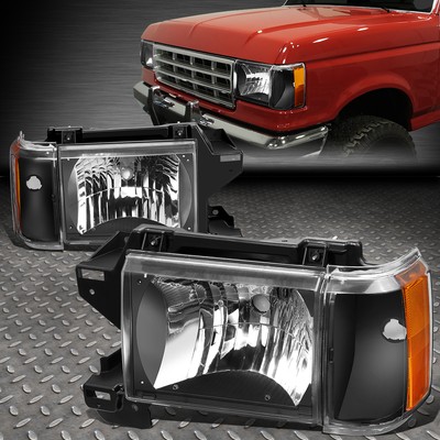

This is a cheap set of head lights I see on ebay with a clear lense.
Im not sure on the quality of the lense and to how long before they turn yellow, so there is this uv clear to keep that from happening.
Nice, so $150 for those and $170ish for the introductory level projectors = $320 plus tax and shipping for the DIY approach. Not too bad at all. As long as it works! ;Really
