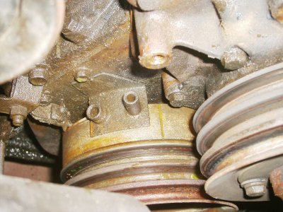

Here is a pic of you timing marks, at least from my 1983, your milage may vary.
You will need to buy, rent, steal, borrow or go to someone that has timing gear.
You can also use a certain timing light and a Ferret (If I remember right) meter.

thanks guys,i forgot to add he took it to 2 different diesel mechanics and they said it was in time. But the guys around here are kinda shady.And would that have anything to do with it shifting into 3rd gear with in 30 feet?
johneich
John, 1983 F250
Jan 6, 2011
474
Southern Illinois
A lot of times supposed mechanics will tell you to leave it, then they time it by ear, it won't be accurate that way.
