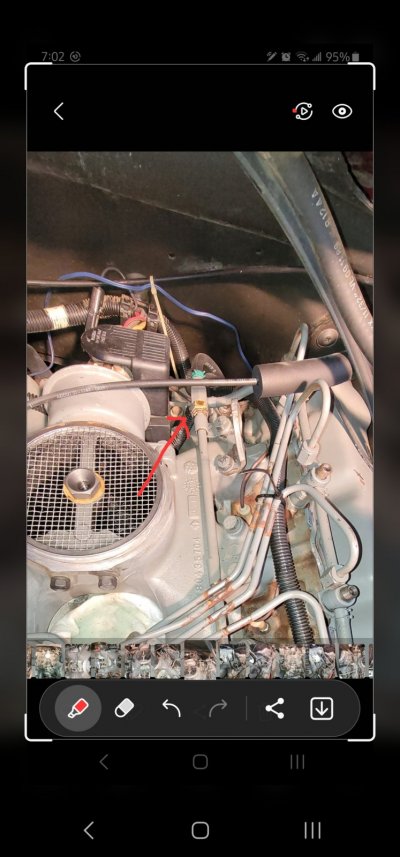

Question on return lines, Moose Diesel is supplying the return line kit, do these kits generally include the grommet/gasket for the rear return line fitting or do I need to source that somewhere else?

No they do not include them. I'll bet that they can include some for an extra price if you ask. They are commonly called olives.

It can be. If it doesn't seal, then that can allow fuel to drain back to your tank which will let air into the system.
