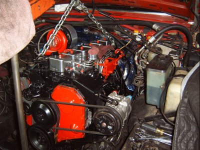

I had a couple of minutes to throw in some pics:

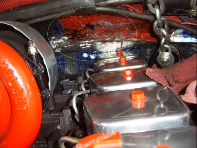

What part of the firewall did you have to beat on to make it fit? Was this done to the donor truck too? I hope you were cognizant of what may be on the other side.... ;Really
This area doesn't look quite as red as it did before.

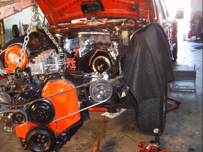

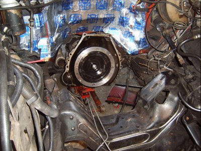

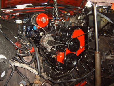

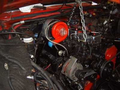

Tony, and I got the motor bolted In today! ;Sweet That was no small feat but it is in there. I had to get a new trans mount, as the old one was shot. I still have to drill 3 holes and bolt in the drivers side of the trans crosmember to the frame. I hope to get to that tomorrow, along with the TC to Flywheel bolts. Then just start wiring stuff up, remove the old guages and get the new ones installed.
Now that I have it in place it looks like the Down Pipe will be a little more challenging than origionally thought. Not whure how I will do that yet, I need to find someone that can fab up toobing.
wow cant wait till i get to do mine were did you get those valve covers?
Those are the stock aluminum valve covers, I just had them polished, along with the intake plenum.
Hmmmmmm. Dosen't it feel good when its in..... Nice... Very nice indeed. I like the idea of the Fat Mat on the noisy side of the firewall too. Time for me to be buying about 150 square feet of it....
Yes it does feel good! Thanks,.. The Fat Mat took a beating with the firewall but we were able to replace it today so It is still functional. I ordered 200 square feet of it. I think so far I only used 100 of that. That is the inside of the cab, cieling, doors, firewall so far. I want to do the underside of the hood, then I am taking the odds and ends scraps and putting them on the insides of the door skins. 150 feet will be plenty.
With Rons expertiece cookoo of removing dashes, he seems to think that we had penty of room. The Dash isn't bulged out any so I think we are ok. If not I will have him remove the dash and fix it,.. :backoff :D
Ill take some more pics tomorrow, the FatMat now covers up most of the carnage.
385
Hmm... would a body lift have negated the need for that beating? Not criticizing the effort mind you... Even a standard IDI turbo install warrants some firewall abuse.
