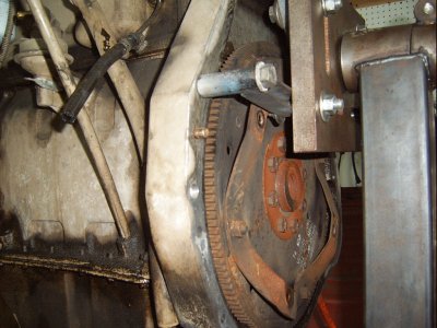

boy some guys will go along way not to have the hear the sound of ONLY 6 cylinders.;Poke :D That thing is going to be quiet inside.;Sweet So what's the wave ring? IS it supposed to be bent? :confused:

boy some guys will go along way not to have the hear the sound of ONLY 6 cylinders. That thing is going to be quiet inside. So what's the wave ring? IS it supposed to be bent?
Hope it works!,.. I have had a lot of ambient cab noise so I figured now is as good time as any to see if I can quiet it down. One if the things that made it noisy is the aftermarket Oil pressure guage. I used a Copper Tube instead of the vinyl tube and it carried a lot of noise into the cab.
As far as the wave ring, yes it is supposed to be bent, here is a pic of it installed on the flywheel. It worked fine for a stock Cummins but with the power that I am now getting out of it, I was worried that it is a weak link in the chain. There was a spot on it that looked like it was starting to buckle and I would assume that was from me modding the Cummins and runnig it hard while it was still in the doner truck.
I plan on keeping the wave ring in case I decide to drop a 4BT in the Bronco. It should be able to handle that kind of power,...
