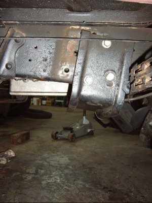

I got some more done on the truck tonight, got the transmisson crossmember drilled and bolted in its new location, got the new trans mount installed. Also rebolted the torsion bar back to the motor crossmember with shortened bolts so they won't hit the Cummins oil pan.

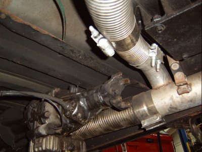

So now the driveline is offically bolted in to its perminant position, and all clearances look good. The motor is level, It is still close to the firewall but should be ok, the rear of the GV clears the custom exhaust.
Tomorrow I will be measuring the driveshafts and taking them to D&R Driveline to have them rebuilt to the proper length. Then get the spacer bolted to the flywheel. After that I am done under the truck for a while so I will start with hooking up the motor, wiring, ac, alt, hoses, etc.

Today we took the measurements so I can have the rear driveshaft shortened, and the front one lengthened. The offical measurement is 4 1/4" That is how far we moved the trans, transfercase and Gearvenders back to make room for the Cummins.
I bought all new u-joints, and a center carrier bearing and took those parts along with the driveshaft's to D&R Driveline here in GR. They will lengthen and shorten, install all of the new parts, and balance them both. I should have them back on Friday.
Here are some pics

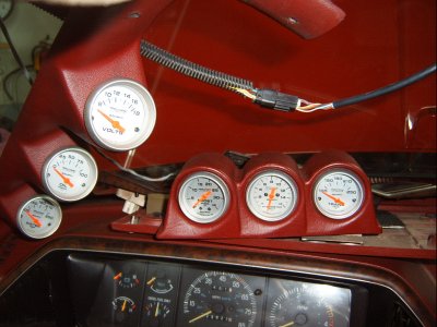

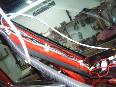

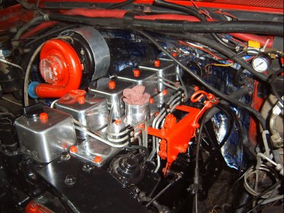

Just a quick update, Tony and I got the flywheel to spacer bolts installed. I had to open up the flywheel bolts a little, and they took some time to get in but it is all buttoned up.

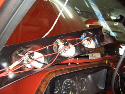

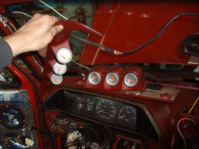

I got the throttle cable with the cruise hooked up and started getting the new guages installed so I can hook them up. I got all matching Auto Meter Pro Comp Ultra Light guages. I need a higher boost guage than just 15PSI, and with a 5K motor under the hood, I figured it was cheap insurance to have good guages.
The new B&M Floor shifter is in the shop also I will install that when I see what I can do with the T-Case shifter.

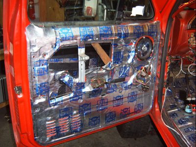

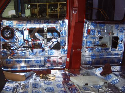

The sound deadening is basically done, I will be doing a little sound wiring and soon will start reinstalling the interior. I sprayed the inside of the doors with spray in sound deadener/undercoating, and then all of the extra scraps of Fat Mat is going on the inside of the doors as well.
Here are a few pics:

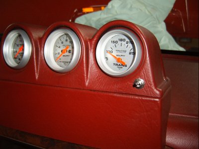

So being one that can't leave well enough alone, Yesterday while finishing up the guage install I decided to add a switch to the trans temp guage.
There is a sender location in the trans itself, so I put the new sender in there, and my old sender is inline. It is located in the hot line after the radiator, but before the aux cooler and aux bypass filter.
So now I can toggle to the acutal trans temp, or the hot line,..
Sometimes I just like to make more work for myself,cookoo but It might be cool, hope it works.

Actually Darrin it will neat to see the difference in temp differences - I know that my trans shop said keep it under 200°F if in the pan and 225° all day lone in the output line.
