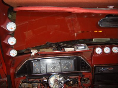

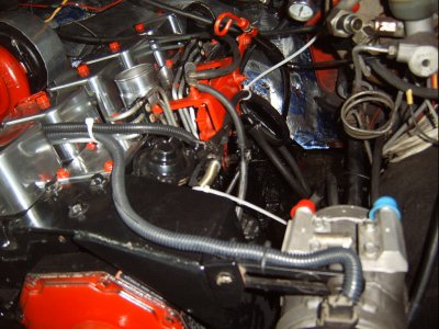

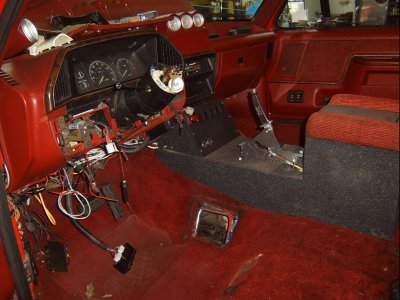

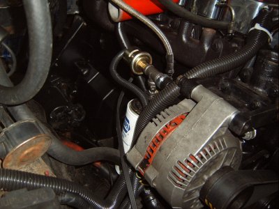

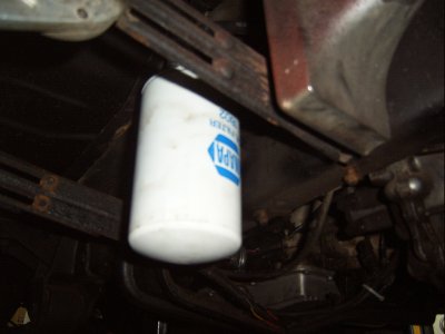

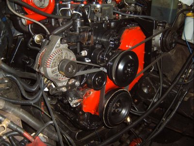

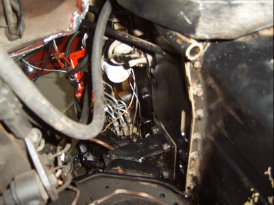

Here are some pics of the progress:

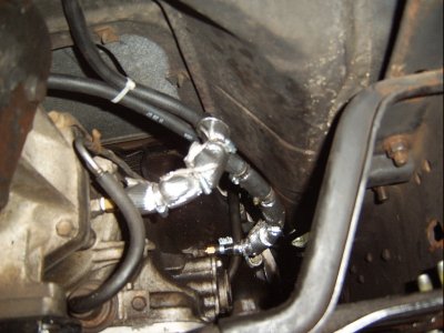

Interior going back in with the sterio, counsol and new floor shifter getting hooked up, Trans cooler installed, lines run, aux filter on the frame. There is a shot of the tranny lines that will be by the exhaust, I wraped them with wire loom, and then the heat proof wrap.
Shots of the motor wiring etc:

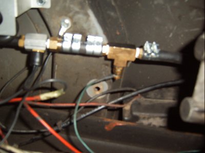

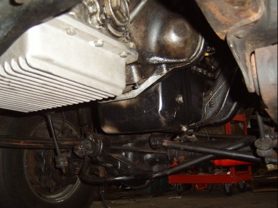

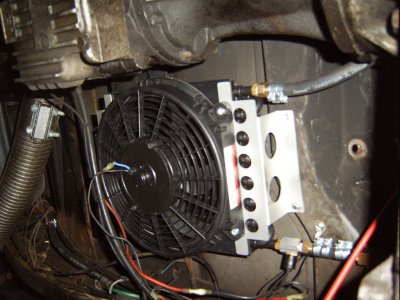

Few more pics:
The one with the 2 senders is the hot side of the trans going into the cooler. The first sender goes to the toggle at the temp guage, the other kicks the fan on at 180 deg, and shuts it off at 170. ;Sweet

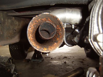

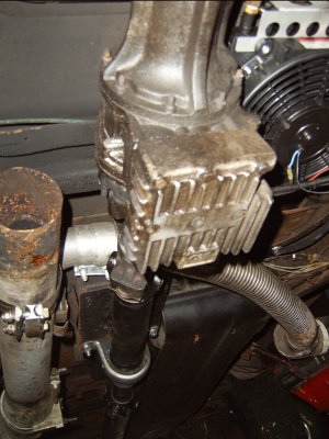

On another subject, While I was taking pics,... For those of you who have seen the Big Ed Video have noticed and probablly been desturbed by the amount of exhaust coming out of the right side of the truck, and the very little exhaust coming out of the left side of the truck, about 90% to 10%
Shortly after that vid was shot I took care of that situation and now get close to 50/50 on each side of the truck. Now that the exhaust is removed I took a shot down the pipe to show how we did it.
We took a short piece of 2" pipe with an elbow and welded it to the inside of the 4" pipe, it grabs about 1/2 of the smoke and puts it on the other side. That way I get both rear rims equally dirty
Thought you might like to take a peek,..

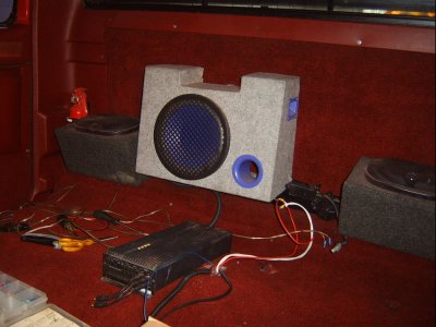

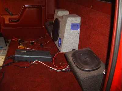

I got the amp, speakers and rear power slider window all wired up and it all works. I got the B&M Shifter installed and hooked up. I had to bypass the nuteral saftey switch, and the reverse lights, and run the wires to the shifter. It all works!
Where did you get the switch? That is exactly what I looking for for my truck.
isn't 180 a little on the warm side for it to just start to cool?
I got it from the hot rod shop up the road from me. I think it was like $35 or $40.00 I can check tomorrow. If you want I can pick one up and ship it to you, let me know..
No, especally since it is on the HOT side of the tranny line. My old tranny gauge didn't go into the yellow till 220. I will be able to monitor it with 2 sendors that I have on the new tranny gauge., One on the hot line, and one on the trans itself.
