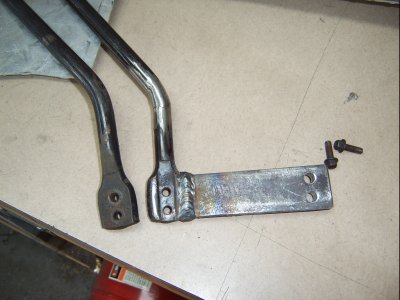

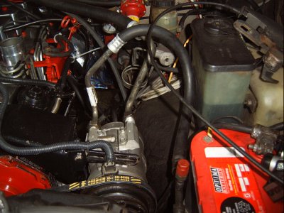

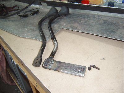

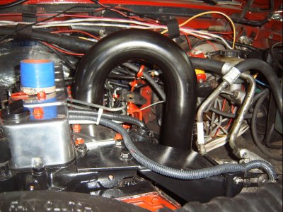

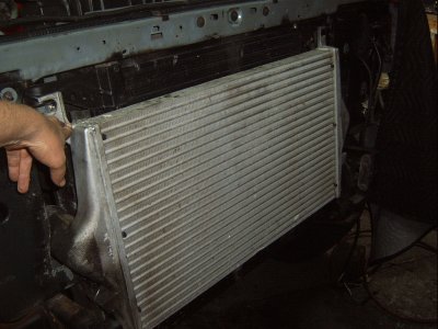

Here are a few pics of the latest progress, I will post later cause I gotta get home,..

Thanks RJ and Barney for the offers on the AC lines but looks like I am able to use the stock Lines with no modifaction. I got the AC Condenser in place tonight and the lines will line up and not be in the way of the IC piping. ;Sweet
Got the front of the truck trimed for the IC. Tomorrow I will make a cople of brackets and get it installed. Looks like it will be completely plumed and installed tomorrow of all goes well.
As you can see in the pics I had to add 4 1/2" to the transfer case lever, it cleares everything and works great.
Not knowing what an Eaton Switch is - B&M has some T-handles that have a switch for a trans brake or a line lock (drag racing stuff), and most B&M handles are universal among their shifters - how about installing one of these on the shifter you have, then wiring its switch to some electronics doo-dat that takes the momentary on signal from the handle switch and translate it into a continuous on/off signal (much like the stock OD control switch works on an E4OD truck
I'll get a pic of the Eaton Switch tomorrow, It is a lot simpler setup and that is what I like. So far it seems to be woking but I can't get the Auto Drive to kick in. The way it hooked up it should be able to use it as an automatic, or have the choice to kick it in manually.
