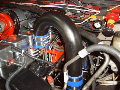

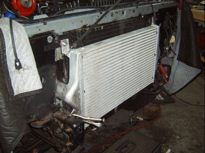

I will get some pics tomorrow but am getting close to running it. The Itercooler is installed and 85% plumbed. I needed to buy the Ford boots for the intercooler and had to wait a day to get them. Bummer part is that I bought the whole inercooler tubing kit for like $120 shipped, the 2 boots and clamps that I needed from Ford were $118.00. :rolleyes:

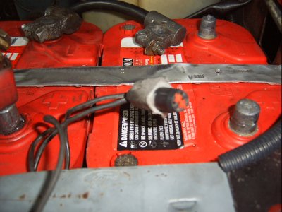

If you need more room in your engine compartment, you can take 2 Optima batteries, turn them sideways, and with a little modification they will sit together on the drivers side battery tray, freeing up the passenger side. that is where the big ole air cleaner will be sitting. Ill post pics tomorrow. ;Sweet

how are they hooked up?
I ran each neg batt cable from the batts to the motor, and the positive to the positive, then across to the silenoid.

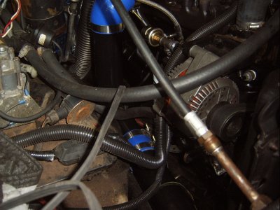

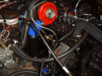

Here are a few more pics, but the all of the batt cables arent installed yet. I'll get some better battery pics when they are hooked up.

I ran into a small problem, but am going to remidy it tomorrow. With the dual Optimas on one side, there is not enough room for the headlight plug. It looks like I can remove the plug, and splice the wires directly to the headlight. I got the parts to do it today will install it tomorrow.
