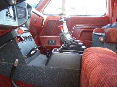

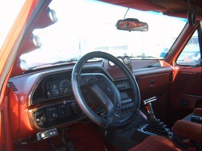

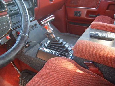

Darrin, glad you got it all ironed out and working good! What did you end up doing about that Eaton Switch for the overdrive unit? Throw in a pic if you can
Yup, It is working but not how I want it to. I used the wiring diagram for the dimmer switch, but attached it to the eaton switch. What happens is it works great for manual mode, but won't go into autodrive.
How Autodrive works, it is just like an OD trans, it kicks in automatically at 45 MPH. I want it to work that why when I am just driving it, then when I want to work it, or get on it hard, I can do it manually. I need to call GV and find out what I need to do.
I also don't know if it will shut off when I come to a complete stop if I don't remember to hit the switch. IF not It may hurt the unit.
Here are a few pics, I am still adjusting the T-Case shifter so the knob isn't installed yet.

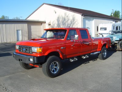

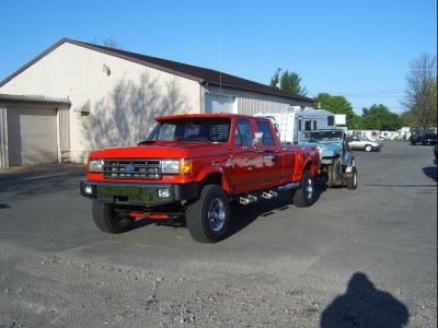

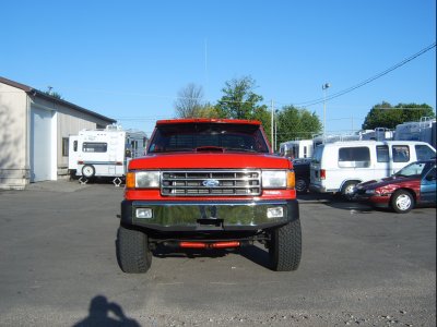

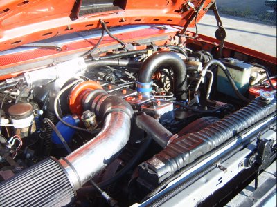

I got to tow with it today, Needed to move a CJ small block to the lot. It runs awesome but won't know how strong till I take care of the Intercooler boots.
I put about 100 miles on it this weekend, there are a few issues to work out, some wiring under the dash decided to smoke on me, I have a leaky injector, the VRV will need some tinkering, Tac does not work, stuff like that. Just need to work out some of the bugs that go with a project of this magnatude.
Overall, very happy so far!
Here are some more pics, New front bumper got installed also,..

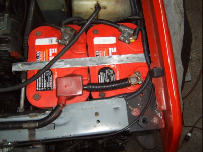

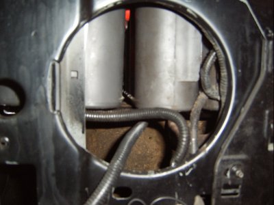

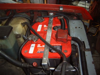

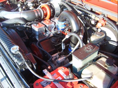

Here are pics of the Batteries that I promised. The 12V Cummins doesn't require dual batteries, but I wanted them anyway.
BTW This morning it was 30 deg, no glow plugs, no heater grid, not plugged in, it started in less than of a second of hitting the key! :thumbsup:
