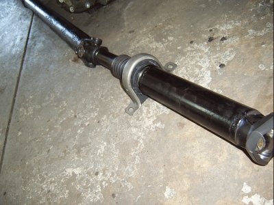

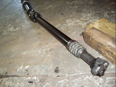

I got the Driveshafts back today, they look great, New carrier bearing, 6 new u-jpints, front lengthened, rear shorten, rebuilt and balanced. The total cost was about $265.00 for everything. It is a lot less than I expected!

Man, you did good on your driveshaft work...I paid about the same when I did my 2wd to 4wd swap but I didn't get all that new stuff too, just a couple of new u-joints for me.
Yea I was real suprised at the price and the quality of work they did. I have heard for years that D&R Driveline was the place to take any work like that but never had to use them till now.
