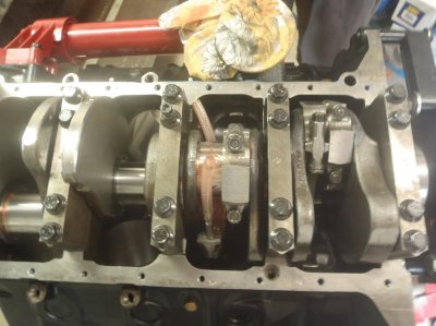

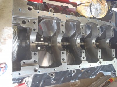

Hi All,
Its been a while since my last post. I've had no end of trouble trying to get another cylinder head. I was offered a set early in the piece and in hindsight I should of taken them. Thanks Mel. I'm hoping that problem's been solved, I ended up getting 2 remanufactured heads out of DCW in Oregon through the auto parts /wreckers that I've been dealing with here. They ship a container over every month from the USA full of parts for all the imported models over here. I ordered them before Christmas and then had the good fortune to get caught up in the west coast dockers industrial dispute. They've now arrived and should be here in a week or so.
While I was waiting for the heads, number 4 cylinder wall started get a small mark about the size of a match head about 1 3/4" down I tried to get a picture but couldn't get it to show in the photo. My first thought was cavitation, I don't know the engines history that well and it's one of the early 7.3's. I tried dye penetrant testing which didn't show anything but couldn't convince myself that it was nothing. It got the better of me so I pulled the engine down again and sent the block off to get pressure tested. The machine shop tested it to 100psi with no indications, even the core plugs held up which is reassuring. I installed the 7 dished type(used genuine ford) with a tool I made from dimensions I found on this forum
I think it was from one of RLDSL's or Gary's "Icanfixal" posts.
So I,ve started to reassemble the engine again I've attached a couple of pictures. It was a bit easier second time around.
I've been thinking about drilling a hole in the core plugs that block the water passages on the 7.3's to allow water to flow through for better cooling, from what I can tell the old head gaskets had a 3/16 hole in them. At the moment my plan is to drill a 3/16 hole in the core plugs(block & head) as well as the gasket. What's your thoughts guys?
Its gets pretty hot here at times and I would like to improve the cooling system in any way I can.

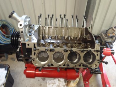

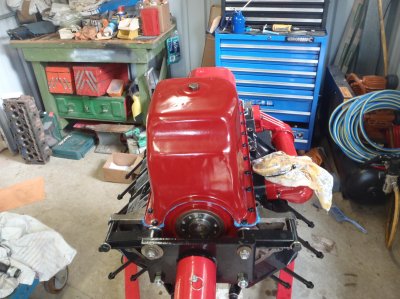

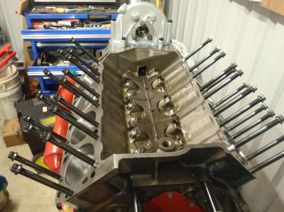

Got a little further today. Fitted the sump for second time, the harmonic balancer and water pump pulley.
I even remembered to put some sealant on the harmonic balancer keyway before I fitted it. :D
I should have the heads by end of next week, the first job will be paint them and I can start fitting them out with valves, springs etc.
