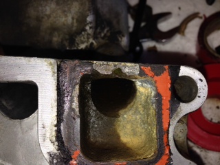

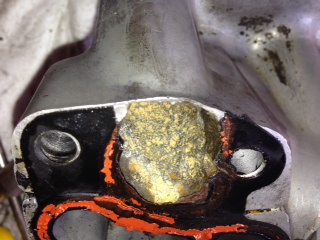

I hope to hear back from the machine shop tomorrow on what needs to be done. They have a good reputation, it's a family business that been operating for a long time. I'll make sure they've checked the valve guides. I pulled the oil cooler apart a couple of days ago and went a bit weak at the knees, I was very close to cooking the engine. The rear housing was just about to let go, the front is salvageable, I'll be able build it up with the TIG. I've got a few lines of enquiry out for a new rear housing. Ford discontinued them a fair while back it seems but there might be one tucked away on a shelf some where, although I might have to sit down when I hear the price, if they can find one. The cooler bundle looks OK so far. I've attached a couple of pictures of the housings.

Wow I'll bet IDI's are rare in your neck of the woods. That said you probably see 70 series Land Cruisers all the time.. I'd love to get my hands on one they're rare and expensive around here. Funny how that works.. Anyway looks like you're off to a great start :sly
Both the front and rear oil cooler housings are still available thru both Ford and International. They are expensive too. Sad that the water in the cooling systems eats away the aluminum. Best of luck TIG welding that. JB WEld epoxy might be a better repair idea too. When you refill the cooling system with coolant and water please use steam distilled water. That has no minerals in it that will drop out and eat away the soft metals it contacts plus.. Its not a conductive water so electrolysis wont be a factor again.

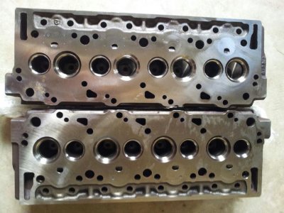

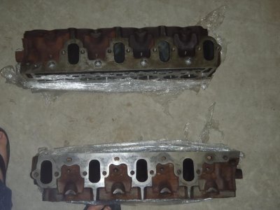

Finally got the engine back from the machine shop today. I've got a couple of questions, I'm hoping someone might be able to help with.
I had to get another cylinder head as one was cracked was cracked. The new head is slightly different in the blocked off ports where the inlet manifold is bolted the replacement head has cup type welsh plugs fitted where as the original has only an oval port that is blocked off by the valley pan gasket.. The replacement head has the numbers 1809 215 C91 stamped with C3 cast after it and the original head has the numbers 1809 03 0C1 cast into it. I've measured everything I can think of and they appear compatible. Are they?
The original heads had pre cups that were cast with 88 on them the replacement head had pre cups that had 84 printed. They've mixed them up and I have 88 and 84 in the same head do you think this will be an issue? They have a different shape to the throat.

Your replacement head may be a 7.3 head. The plugged coolant ports on the intake side was a 7.3 upgrade. I had the machine shop install pipe plugs in those ports on my 6.9 heads. I didn't want to rely on the intake gasket plus gasket eliminator sealant to keep coolant out of my crankcase. Check the head gasket side of the head and see if the coolant passages at the lower corners has a cup plug. The 6.9 has a triangle shaped coolant passage at the corners. You could check diameter of head bolt holes as the 7.3 increased the head bolts to 1/2" from 7/16 for the 6.9. I don't have experience with the pre-cups but the 7.3 and 6.9 did have different cups. I believe the injector protrusion in the head is slightly different between the two.

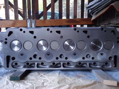

You're right its a 6.9. I measured everything except the the diameter of the head bolts. I'm feeling rather stupid right now. I found some more info on the casting numbers this morning they confirm it as well. The first pic shows the plugs on the intake side of the 6.9 and the second pic shows the 6.9 at the top you can see the smaller holes for the head bolts but the water ports are round. So I have mismatched heads and pre cups, what a mess to sort out. Time for a few cold beers and a fishing trip.

Is your block a 6.9 or 7.3? In USA 87 IDI's came with 6.9. I see in your first post you said it was a 7.3, but the description of the original head was a 6.9. Maybe plugging the ports on the head gasket side was only done on US 7.3's.
Edit: Here is a picture of my 6.9 head. The coolant passages at the corners are triangle shaped.
