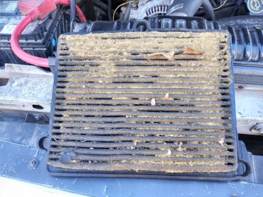

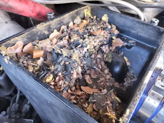

I keep the snorkle tube off LuLuBelle in the winter, or use the dryer vent hose
My air intake (after installing a factory turbo setup) is also a piece of 4" metal dryer hose, open on the end. Unfortunately I too have found that it's a packrat highway (boost disappearing, more smoke, and filter restriction tell-tale pegged!). I need to clamp a piece of hardware cloth (like a really heavy-duty screen) over the inlet.
