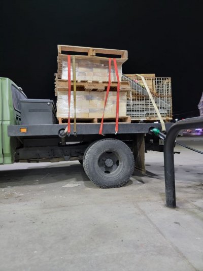

Well yesterday, I hauled 2.5 tons of kiln bricks and shelves on the bed of the Chief. Honestly it handled it like a champ and didnt really even break a sweat.
But today, I pulled the power steering pump off and rebuilt it to address a leaky body-reservoir oring. I had been dumping fluid on the ground for a while and i got tired of the leak-whine-fill cycle. that went pretty smooth actually, I even went so far as to press out and in the input shaft bushing that was supplied with the kit. New from seal and o rings all around, as well as took the opportunity to replace the high pressure line with the one ive had on the shelf for a few months now. a whooole lot easier to do with the pump out. so $20 for the puller kit from HF (I dont rent small tools) and $7 for the rebuild kit, I would say that the satisfaction of learning the innards of a nother part on my truck was worth the extra hour or so it took me to clean disassemble and reassemble. vs just slapping on a questionable reman pump.
Side note, I forgot to put the "cold air intake" tube back on the air filter housing, and besides a little bit more engine noise in the cab, does anyone know if that actually makes any noticeable difference in performance, in any way? or is it really just a restriction for the intake.

Cooler air is more dense and can help combust fuel better than less dense, hotter, 'underhood' air...and...since the inlet for the tube is out front, at the nose of the truck, it provides a 'ram-air' effect while you are going forward..(at speeds faster than walking speed).
If it were me...I would put it back on and leave it...unless you like the extra sound...it also keeps water and muck from splashing up and into your air cleaner filter...
