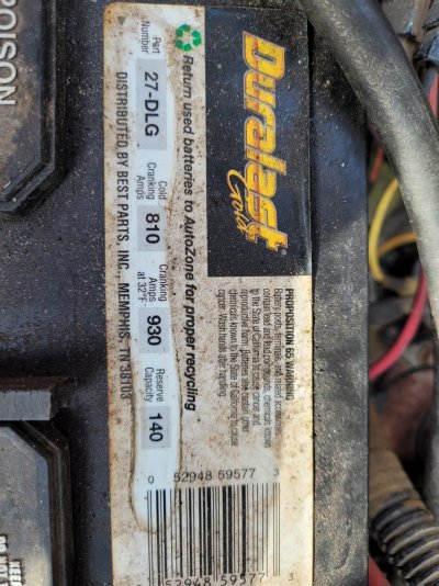

What group size are your batteries? I notice you have the plastic Hold Down on the drivers side.
I picked up several from PNP and don`t work on the group 65`s. too narrow.

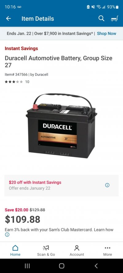

OK, Thank You. Looks like the same cranking amps as the Group 65.
I got mine at Costco, think around $100 ea.
Maybe the group number has to with the dementions of the battery. IDK.
