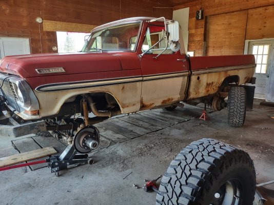

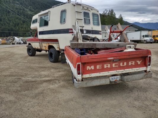

I used my 1970 Highboy 7.3 idi to move, 600 Mile's each trip, hugh some pretty steep highways, namely Jasper Nationional park Alberta. 3 trips through there, and two more up through Kelowna and Williams Lake route, to Sinclair Mills where I bought my new home in the country. Broke my bellhousing on my return trip for the camper and pickup box load. Had to borrow the X's hybrid hyndia car to go back up and get my spare. Another 9.5 hour trip each way, and , lost an injector line , front left side cyl bank. Got the brackets on and that didn't happen again. Overall a good hard 20 days of moving, 5 trips with the 'OldMan' (52 this year). Trip one; canopy full and the boat. Trip two , truck parts and Samurai, trip three cargo trailer, trip 4 haled the oil tank, and snowplow with the 71 Meteor that I sold, and trip 5 emptied the pickup box to haul the camper , and pickup box trailer for shop goodies. Finally got the camper off the truck yesterday. Lots of boxes and shop tools and equipment moved. Ordinarily, it's a 11.5 hour trip each way, so the OldMan got a real good workout, all my upgrades sure helped over the last 7 years, and more needed. 4 core aluminium radiator really made a difference, new water pump, but needs a good overflow bottle. New turbo downpipe, helped too, but, I could have had the fuel turned up some, never did see any black smoke. Cargo trailers brakes didn't work at all, so the 4spd coming down hills sure helped. Almost turned some crazy tourist drivers into macaroni, in Jasper,NP. Another story, very full cargo trailer wieghing in around 10,000 lbs, etc

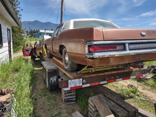

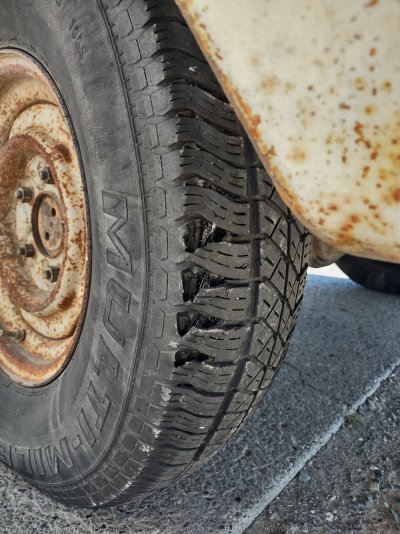

Also lost one tiree on the trailer due to heat, did the bellhousing at a friend's place, he was very helpful, David. He also helped load the camper. Here's another one of the truck getting the tires rotated, . The trailer, a 26 foot , (18.5 foot deck) I built for the move during all the real estate business. For 2 months preceding the move. sure worked out well, still some things on it to do.
What is it that you did to the bell housing? It looks like its been messed with, but I can't figure it out. And Koot, what kinda tailgate says "Mercury" on it? I'm about to Google it!
A rare truck and belive that one would to be a 67 since no side marker on the bed
edit: could be a 68 but thought they had side reflectors

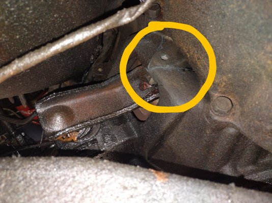

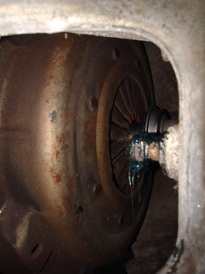

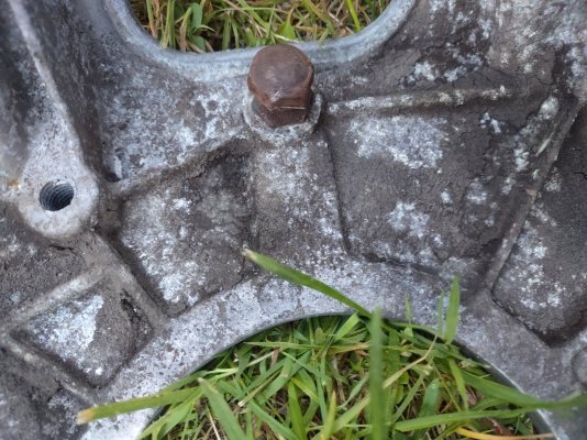

The pivot bolt, had not been lubed often enough I think, my bad. Here's the replacement housing with a good pin. I was in a hurry and didn't snap enough pics . I'd also fixed a couple cracks in the y-pipe while it was apart. Here it is, back together with some grease on it. Before the fork was back in place. And boot.

Installed a new throw out bearing too, no time to order a clutch otherwise I would have, it's 19 years old now
You can see the cracking, right where the pivot for the fork attaches. These bellhousings are prone to crack here, the pivot came almost out off to one side, bent, not sure what happens first.
There's another guy on here that had his crack there. I'm thinking about going back with to the t19, if I do I'm going to fabricate a bracket to brace that pin up. And I do fantasize about making a matching truck bed utility trailer for my dually.
I've actually got 2 of those tranny's and bell housings, one of them is cracked.
