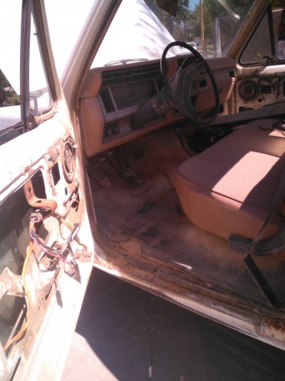

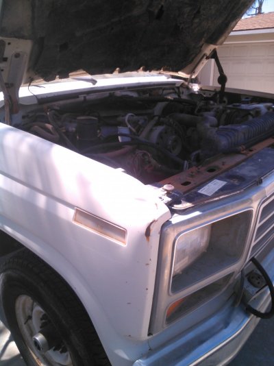

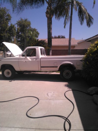

Not so much my truck but what I did was convince my dad to buy this 85 6.9! It was an old date farm truck down in So Cal outside of Palm Springs. He was able to pick it up for 3K and the guy delivered it to his house about 90 minutes away.
it needs some cosmetic work for sure but it is a 4x4 with automatic with only 85k miles on the engine. I guess he was able to verify that with the seller.
My dad has always been a gear head but this is his first diesel. So when he bought the truck I sent him some odds and ends and today we face timed as I walked him through replacing the return lines and engine temp sensor. Y’all should see how they had that thing rigged up!
