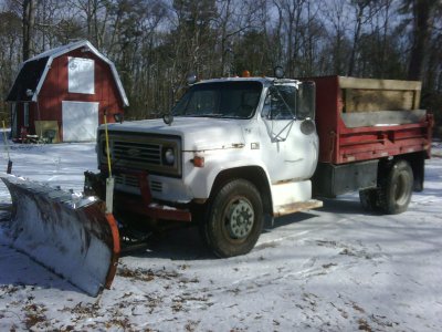

Well IDk if you heard but the north east is going to get walloped Friday and Saturday. 12- 24" expected. With that in mind I have brought my build into overdrive to get this tuck making e money again. I hate to test the bugs of this build in a blizzard but I need to recoop some losses. Here is where I stand. Pics from phone are in next post.

It is funny that you say that. Fired up truck today for the first time didn't get her started but man o man leak O rama everything from water to fuel. On the fuel lines I had all kinds of leaks. Under the caps, through the injector threads. ***. I dont think I will be plowing with this truck this storm.:mad: But it is probably for the better anyways. Probably not a good idea to have my first test run in 2' of snow and pushing snow for the Town...
Another question, Book says injectors to be torqued to 35 lbs but they still seem to bubble up fuel through threads. What gives? Was I suppose to use some kind
of sealant? I understand the need for new return lines but I don't need new injectors do I?
:shoot: I want to unload my M1 Garand in this thing right now. I wonder how far into the block it would make it...:sly

You should be able to get a return line kit at a good parts store, twice the price is what you will pay vs Mel or Russ. The injectors need new copper washers. It will come together quick, stay on it!! Good luck.

the injectors all have new copper washers on them, and still leak though. Could the crappy return lines cause this? and stick with the 35lbs torque?
