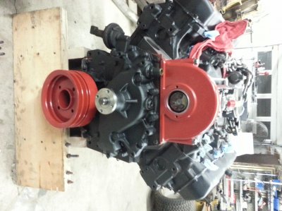

Got Ip timed in today and mounted and painted water pump.

Looks good, can't wait to see the whole truck. I have a C70 Chevy that I'm itching to replace with an International. My dilemma is what engine to choose, 466,360 or 7.3.:confused: I can't wait to hear how you like the IDI in your medium duty rig.;Sweet
PM me if you wish, I have a spare valley pan hold down piece if you're interested.

Thanks goose. I actually found my valley pan strap but honestly its buried under the ip and intake and im not itching to take those off. Ill replace if I have a problem with my improvised one. Here is a visual update.

Yeah baby. It fit like a glove going to start hooking it all up after I hit the gym tomorrow. I forgot to put in the oil pan dipstick tube I hope I can still get to it. Any special procedures when putting that in or do we just tap it in and call it a day? I cant wait to get her going too. I loved this truck before she blew. Even after a bent rod and leaking head gaskets the baby still ran. I would go after a dt 466 I think the 360 is going to be too small for that c70 and you know you can make plenty of power with a 466.

The DT466 (and the DT360 for that matter) are some of my favorite diesel bar-none! Great power potential from either, but the the bigger 466 certainly has more.
It's interesting to see the differences in manifolds between the Ford and IH medium duty IDI's (exhaust and coolant), plus, the front oil sump is cool.
The dipstick on the IDI's may be different, but on the Ford version...... the dipstick is on the passenger's side. It sits between exhaust ports, behind the exhaust manifold. Put a new o-ring on it and slide it into the block. It can be a real PITA to do as with a new o-ring, it's a real tight fit and not much wiggle room with the tube between the ports on the exhaust manifold.
