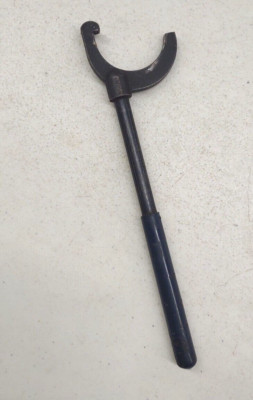

Here are the IP tools in the official kit. Before I got a kit I ground an obstruction wrench thinner and cut a section out to make a flare nut style wrench.
Thats a funky one. Its like an elongated obstruction wrench had a baby with an offset wrench.
Whats the big half moon hook doodad for? Is that to turn the IP and hold it in place while you tighten the nuts?

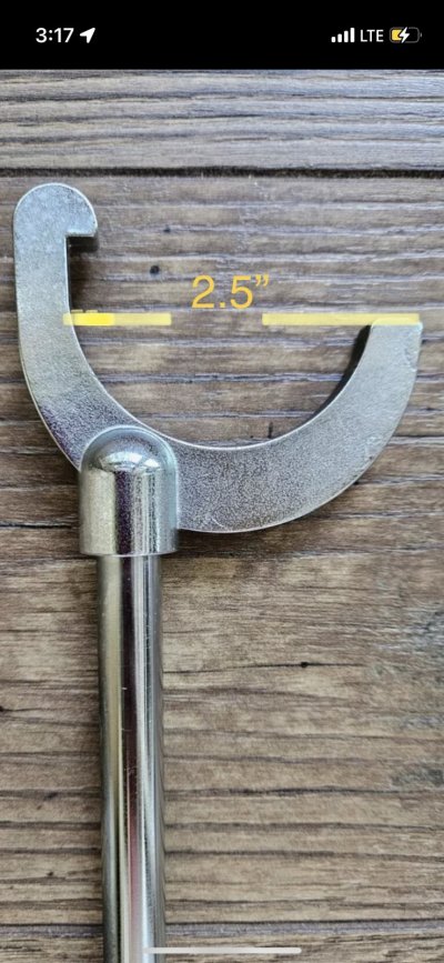

Hi looking to adjust my IP. However my pump doesn’t have this 3/4” square part to rotate the pump.
Thoughts on how I can adjust? Maybe @Cubey i need this special tool you mentioned?
Thanks!
parkergn
Jun 12, 2023
78
29
Toronto
I think I need this bigger style wrench to grab the IP body, since I don’t have the 3/4” square tab like most do….
Do you have a link to this wrench? Thanks!

But where does the hook attach to? With no dedicated mounting point I'm at a loss. I guess there's a seam on the underside? That's the only place I can see that hook getting to and being useful.

No 3/4” square casting to grab. There is a notch under the top bolt on the casting that the Adjusting tool would grab. Can see it a bit better here. This is a “Champion Diesel” injection Pump.

Yes I found those tools on EBay, last night. A little expensive especially with my Canadian dollar… I found this Blue Point SP442 on EBay, Price is right. I wonder if the handle will even fit in the van.
Considering just making on from the images. Could trace this to get a vector. Make a few sizes, laser cut out of wood, test fit the right one, WATERJET the final one.

Thanks for the tender!! Yea I was also thinking along the same lines, if I could find a spot to grab the IP. There’s a bolt on the back side that may work. No notch or hole on the front side from what I can see. How much leverage is needed when the IP is unbolted to move?
I feel like tracing this shape is my best bet.

When I was looking at the tool, was thinking the same thing.
If I had one, make a trace of the tool head, and have someone
cut out with a lazer, Acetylene torch set up, and knock out a
bunch. Cut a slot in a rod for the handle and weld it on.
Or a piece of flat bar.
Or cut out the heads, mail them out and let the end user weld
on his/her (gotta be politically correct here) own handle.
Or trace out the head on some stiff paper, and mail them out
and end user can make their own.
I saw the $20 one also last night. Is the head the same size
as the Rotunda tool?
