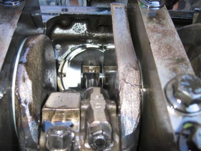

Here's a picture of one installed. If you look up at the pin end of the rod, inside the base of the piston, you can see the rectangular area of the rod facing out. That's how I am keeping track of which side is which.
Thanks Typ4 for the explanation...
BTW just ignore that hairline crack in the crank between the rod journal and the main journal on the right...:eek:
Those of you going to the rally will see what that looked like after I pulled the crank... (thanks to Mel)
Todd

Ok, kust left the shop and showed him the picture. He admitted his mistake and told me to bring it back. If they messed this up, how do I know the rest of the motor is correct? Also, I bought the ARP studs, they should be here in about 5 days.

I am sure they didnt really mess up, you have to realize many more chevy diesels need work that IDI,s and that is what they are used to fixing.:rotflmao:rotflmao:rotflmao
