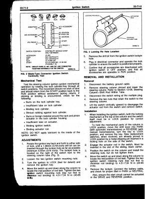

If it is an 88 you are working on the turn signal harness does sfa for ign.
The ign switch is operated by a rod that runs doen column to a slide switch. That switch could be nfg.

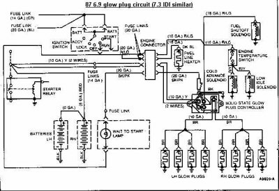

Also the forward most plug losest to engine fan on IP on drivers side which is the largest plug is fuel shut off solenoid.
Sounds like something is crossed and back feeding the syztem or wires ha e shorted out.

Maybe you can figure out what ya screwed up from this diagram.
