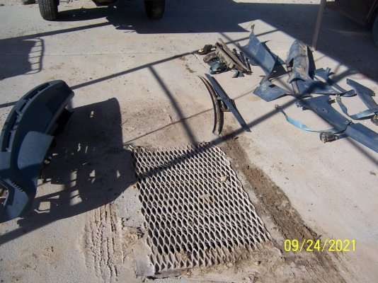

Today, I took the trim pieces to the car wash to wash the mouse yuck off of them. $8.50 later, it may not be perfectly clean, but I think it's good enough. What little is left there should clean up fairly easily with Simple Green.

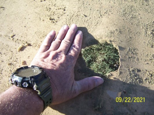

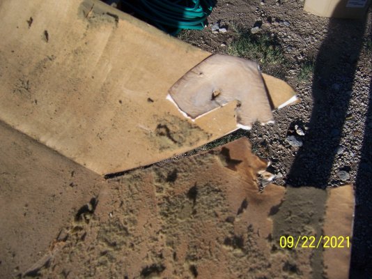

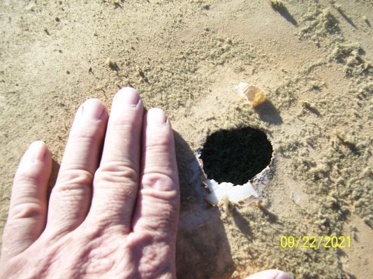

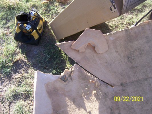

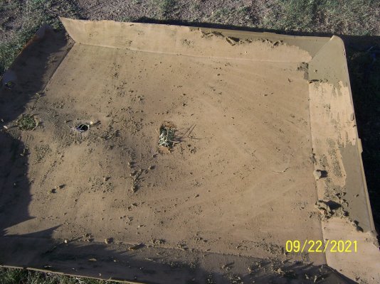

Even though the trim pieces are now clean, I'm going to have to wait for a while longer to install them. The headliner needs some help. The bigger hole is where the hole in the roof from the old style antenna was at. The smaller hole is from mice (I think). I'm going to cut the holes out bigger and put some more cardboard inside them for patches. Both of the front corners came off so I'm going to have to reattach them as well. THEN I can get some more material to cover this all up.

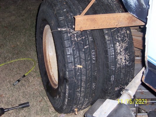

Well I let myself get distracted from this for WAY too long. It wasn't much, but tonight, I put two new tire on her. I had a pair ready, but had to steal them to put on the Blue Truck for a while since the ones that I am running on it were unavailable. I ordered a pair to put on the Ex Wife (again) to replace the stolen ones. I also have now ordered another pair of the A/T's to go on the Blue Truck so I'll put them on and then put the H/T's on here where they belong. The main reason that I bothered to post about the tires is because I want to brag a little. I pulled up to my garage at 4:30. I had to open the garage, dig out my dirt bike, get all the tools ready, kick on the air compressor, take the tires off of the Ex Wife, and dig out the new tires all before I got started on replacing the tires. Now I did remove the valve cores to let the air out of the old tires while I was digging out the new tires, but I had finished airing up the second tire at 5:37. That's pretty darn fast to change out two tires by hand plus add the Dyna Beads and replace both valve stems. It had to be less than 20 minutes per tire. To me that's worth bragging about. No I didn't put the simulators on yet, but I figure that there's plenty of time for that yet. No the dually fenders aren't back on yet either. I think that I'll leave them off until I get the engine and transmission swapped out just to reduce the chances of them being damaged while inside my garage.

Nice work! That IS crazy fast for hand-mounting. I've done about 4 sets plus 2 more tires over the last few years and I'm just finally starting to get comfortable with it! Haha. 2 of those sets were aluminum rims though and they are no fun with hand tools.
15,051
14,149
I sure can believe that. The tires did break down pretty easily with my slide hammer type of bead breaker. The new tires had also been sitting expanded for a while with tube in them so there was no issues with seating them. I did air them up to over 40 PSI with no valve cores in so that part went faster too. I think that I forgot to mention that I put new valve stems in the rims while I had the tires off.
