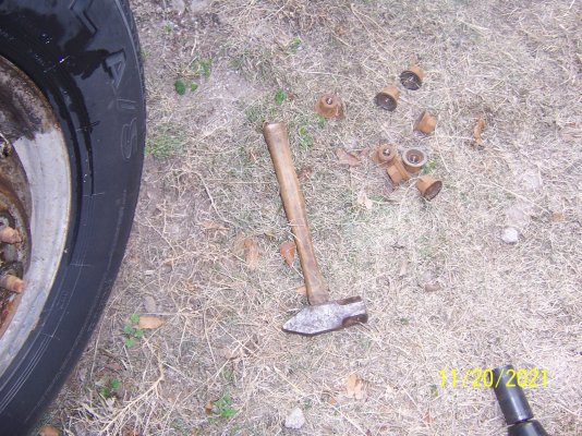

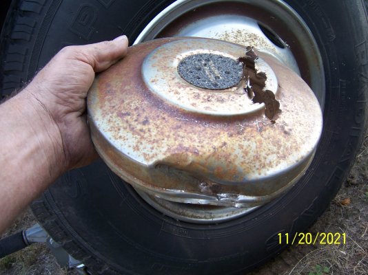

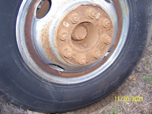

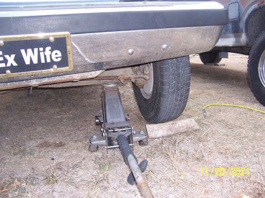

Today, I took the HT tires off of the back of the Blue Truck and put them on the front of the Ex Wife. I found out that extremely rust simulators aren't much fun to get off, but then the wheel was even worse. The center had a rust hole in it. I'm betting that it was facing up where it was sitting and the whole center would fill with water during a hard rain. I had to get mean with the simulator center in order to remove it. That wasn't mean enough for the wheel. I had to let it soak in PB Blaster for about 30 minutes. Then the Instrument of Death was able to remove the rusted wheel. I beat up the inside part of the rim a little bit. I straightened the worst parts the best that I could. Good thing there will be simulators covering it in the future.

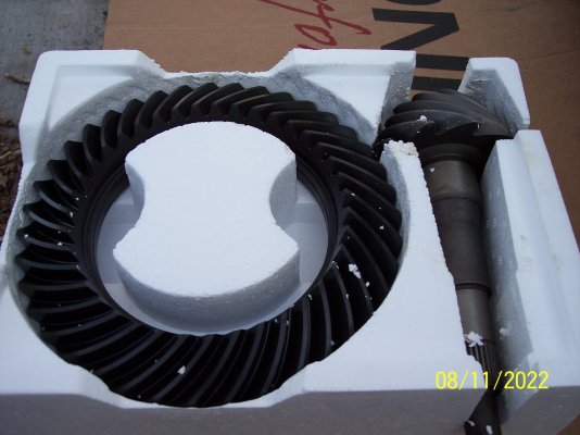

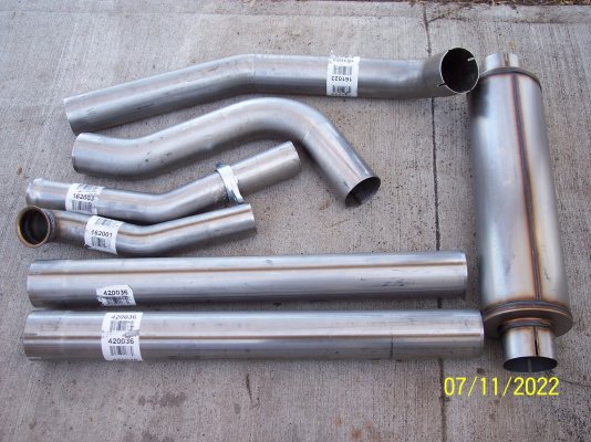

I know that it's been a while, but I haven't completely forgotten about her. I did a little bit more shopping for her in prep for getting ready to pull her off the back burner. It will probably be a few more months, but it's still progress, of a sort. The tightwad in me was squealing pretty loudly after I made the purchase. The logical part of me said "the 3.55 gears will get better fuel mileage than the 4.10s on her now and you like that part. Since the exhaust is 409 stainless, it should outlast me so that was worth it too." The logical part is right, but the other side can squeal SOOO loud. The down side is that since the exhaust is for a first gen 7.3 PSD exhaust and designed to include the catalytic convertor, it may not be long enough. I may have to buy another piece of pipe to make up for not having it.:dunno:Whatever: I'll also be perusing Russ's website for a crush sleeve eliminator after my next pay day. I didn't put the 3"-4" coupler or the hardware to the exhaust picture.
