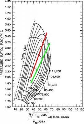

i've already done the research for turbo's. a T61 compressor with a .85 a/r exhaust side would give 15-25 psi all in the same efficiency range. the surge line on this turbo matches perfectly to what the airflow required for our motors is.
a guy at work and i checked each others math and that turbo is great. i just have too many other things to pay on to put that kind of money into my truck. i posted the chart with some quick-math numbers.
you can see that the middle oval is the highest efficiency range and how the need for air at each boost level keeps the line right in the best efficiency range. the green line is at sealevel and the red line is at i think 4400ft or something close to that...
FYI the "Y" axis shows the boost range(in ATM's) standard pressure at sealevel is 1ATM (i'm only at 660ft so its close enough) 15psi of boost would be at 2.00 ATM on the map. and then the "X" axis is where the real math comes in. For most accurate values we need to dyno a N/A motor to measure the volumetric efficiency. We simply calculated it from nominal values.
