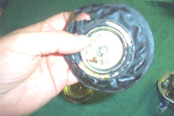

here are some pics of what happens when you attempt to clean the CDR with strong solvents.
bottom line, when in doubt...just replace the damn thing. attempting to clean it will have negative results.
