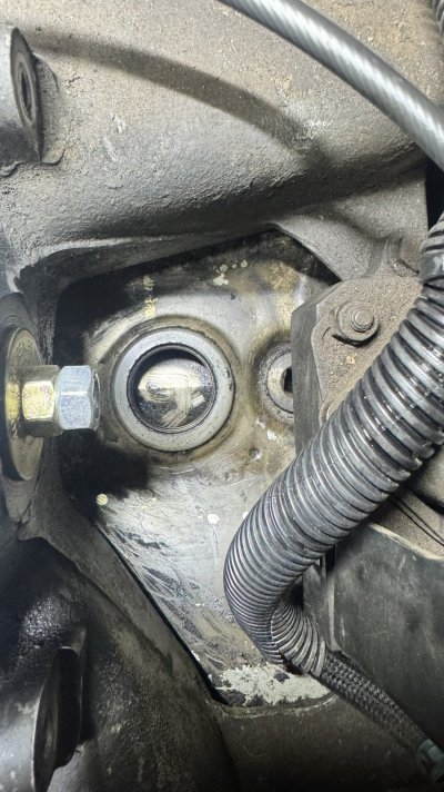

Few yrs ago Russ told us that this would/supposed to work for the grommet in the valley pan. I had this in my computer notes I try to keep.
Mid '70 Dodge Valve Cover breather grommet for ATS drain & Gray RTV)
(NAPA part #NOE6301411... DORMAN part # 42344)
This won’t work. The hole in the dorman grommet is just under 1” and the original is 1.25”
