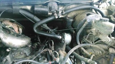

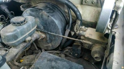

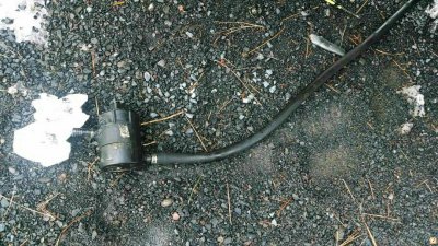

So just got this truck. It was set up with a road draft tube I believe its called. It had that filter on it which seems to be a irrigation filter haha. Except it leaks oil really bad! I want to put it back to normal and have it run into the intake. But I am concerned because all the oil that it leaked, I don't want that in the intake obviously. So this must have something to do with a messed up CDR right?

The CDR will have absolutely nothing to do with the amount of oil coming out of the road draft tube. It's pretty normal to have a small amount of oil coming out of the rdt - unless it's enough to leave puddles under the truck when you park it should be fine to route into the inlet.
Also, the way that system is setup now is suboptimal because the hose is kinked coming off the cdr - that's going to restrict flow and could cause high crankcase pressure leading to oil leakage out the shaft seals/gaskets.
