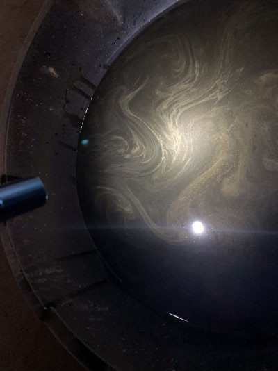

Ok I drained a little oil and had no coolant when I first pulled the plug but I did have something in it. I suspect fuel. Here is a pic showing the oil.
I have lost some coolant so does anyone know what could have caused that? Still a cracked cup and a loose injector/blown injector seal??

I wonder if it’s such a slight coolant leak that the oil (over 200 degrees) is causing it to steam into the ventilation of the engine.

Does the oil you drained out have a fuel smell to it? After setting is whatever is in it settling or separating from the oil?
