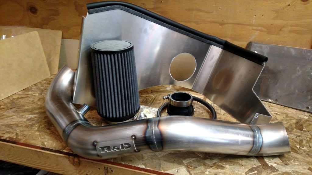

Looking at your pictures I see you used the factory 093 air box. I wonder if that being bolted to the intake is producing the increase in noise you are hearing. Had a 6.2/banks kit that had this "plenum" to adapt the boost pipe to the intake, It was amazing how much that piece of aluminum amplified the engine noise.

Good point! I hadn't thought about that. Since it's most noticeable at idle I could test that fairly easily at home.
