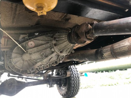

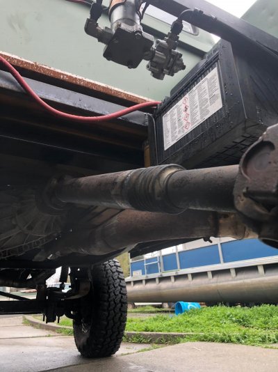

THIS PROBLEM IS FIXED!!!
GOT THE np271 AND THE DRIVESHAFT IN, WELDED THE PERCHES AND NEW SHOCK MOUNTS...
SHE NOW RUNS AND DRIVES LIKE A DREAM!!!
70 MPH, NO VIBRATION, TRANS IS QUIET AS CAN BE!
I AM NOW INLOVE WITH THIS THING AGAIN LOL
THANKS AGAIN TO EVERYONE THAT HELPED ME OUT!
13,320
3,884
Awesome. Pics of the finished assembly?
shtballs. i forgot to upload them
still gotta make an arm for the t case and hook the shifter up.
then its down to a few little things!

Glad to hear it's resolved. Our local shop holds run out to very small numbers too, but I still prefer to have the shaft balanced afterwards. Front shaft looks like it's angle will be just as steep, probably need a dc joint there too.
