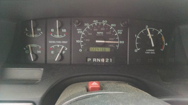

3500 is a little less than mid way in yellow on the F series tach. Econolines never got tachs in 3rd gen, so I had nothing to reference for RPM. Evidently, 6.9s are factory governed to 3800rpm, just before red.
That's interesting, 6.9's rev higher than 7.3's? Mine de-fuels pretty hard by the time it pulls through 3400. The 2-3 shift is so long while towing that I'd like to have a little more headroom at times.
And just for fun, 80mph at 2500rpm is very smooth and easy with my setup:
