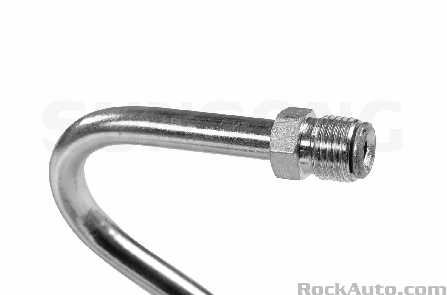

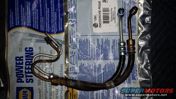

From what I've read for the newer ford super duty box swap. If it's the early SD box it'll bolt right up and you either have to have hoses custom made or you take the old brass fittings out of the old box and put them in the new one and that'll allow you to use your original hoses. Because newer boxes use a o ring fitting and old boxes use a flare fitting. But other than that everything else bolts right up. If it's an 05+ box you'll have to enlarge the holes and buy bigger bolts to math the box. Also if you get a 36 spline box you'll need a new pitman arm. But I believe early SD boxes are 32 spline like ours so you can use your original.
