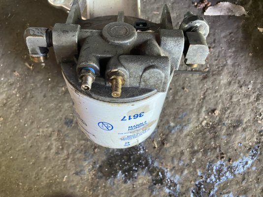

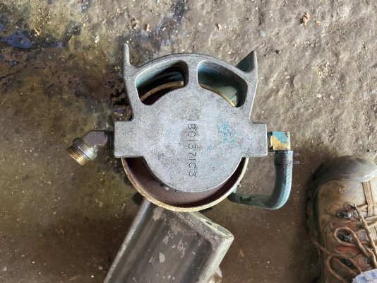

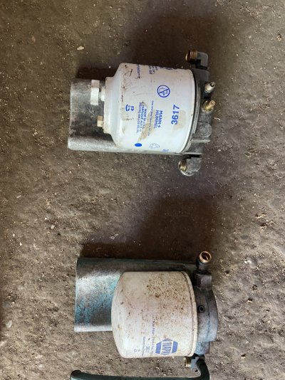

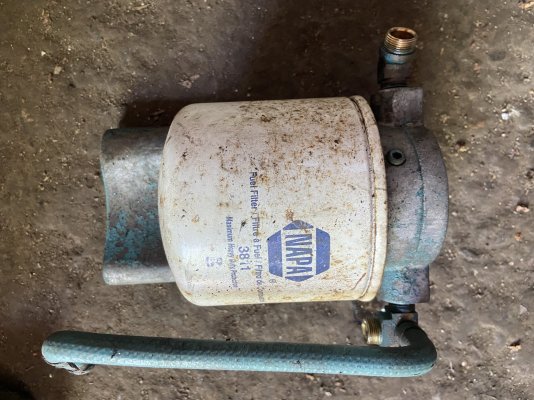

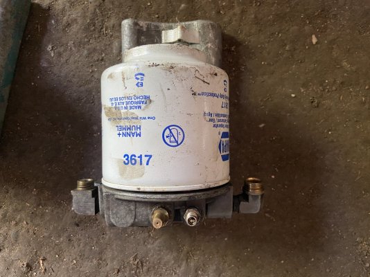

Here is pics Of Both the “bus” and the Van fuel filter assembly.
The bus is basically a bracket that holds the filter. Nothing to leak?
Thoughts or Comments?
Pro/cons for each?

Like you said, the bus filter head has nothing to leak. That's a pro right there. The filter doesn't have a water separator though. it's the 6.9 style and those used the separate water separator that was known to leak. Do you need it? I don't know. I might remember to drain mine once a year and haven't had water issues yet. If you're at all worried, you can put a filter with a water separator before the electric pump that you're going to install. Maybe International never used a water separator on this fuel filter?
