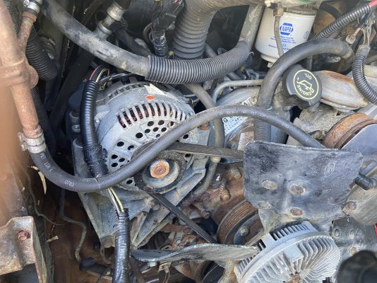

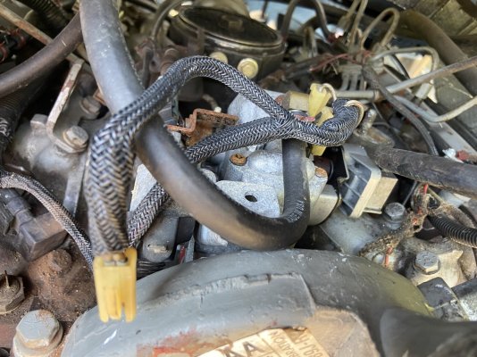

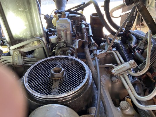

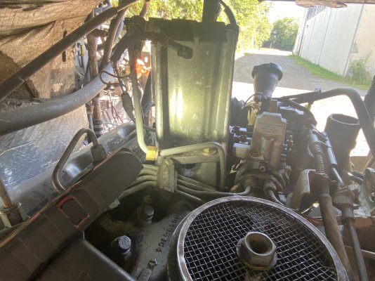

Can you post a picture of the fuel filter mount/head? I don't remember if vans ever got the two piece fuel filters or a 7.3 style filter head. If not, you might still have a 6.9 style water separator. Those are the ones that gave the most trouble. If you have it, you can bypass it like most people do.
VanGo
Sep 7, 2025
61
24
Michigan
Won’t be able to get pics until weekend. Have these older photos already on phone not sure if this will give a clue.

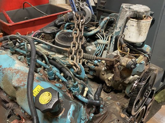

Also found this pic of the bus engine before pulling items off…
I'm impressed you got the IP gear cover off with the IP still in place.
