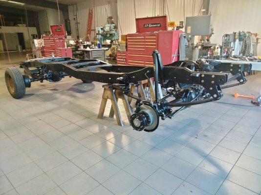

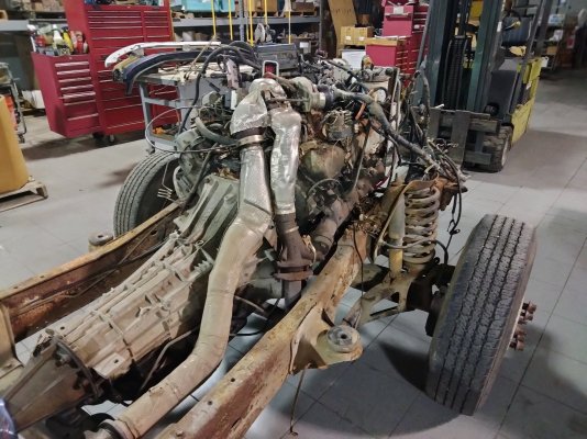

That's interesting. I was always under the impression that the turbo block was a bit beefier. I'm about to examine and reseal my IDIT engine as I am getting ready to install it back into my rebuilt/painted chassis. While I have the heads off (for studs), and oil pan, I'll give a look at the webs and see what I can measure up. Need to consult the guru Justin about this. I happen to follow his Facebook forum. If anyone knows for sure he does.
