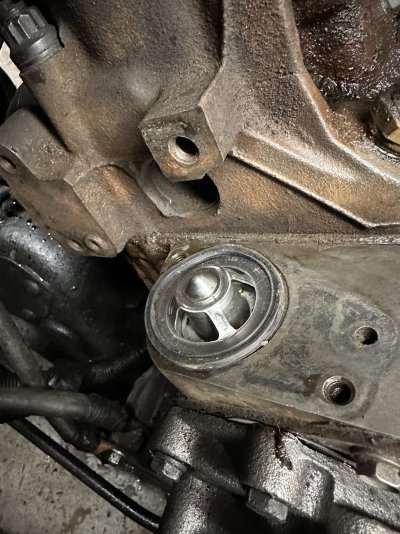

You know, I agree with you about the outside. It doesn’t make sense that it’s there because on the IDI it’s not suppose to have it and the gasket makes the seal. That’s why there’s a machined lip in the block. I started off installing it for fun to see what would happen. Then I took it back apart and figured, why not just remove the rubber.

Well I have a good one for you.
I bought the truck in 7/14. It may have been then or a year or so later, I bought a new Motorcraft Thermostat from the Ford dealer in Santa Cruz. I had it for a couple years, then one winter the Water Pump started leaking, so took it to a shop because I didn`t want to work out in the snowy cold.
I gave them the MC Thermostat to install.
Everything was working alright. Some time later the water temp would not heat up.
I pulled out the Thermostat, and in the center was this piece of rubber keeping it from closing. Pulled it out, and (now I don`t remember it I reinstalled it, or replaced it with another MC)
When I was filling the radiator back up, up floats the rest of the rubber piece.
So far it all works ok and I have heat, and this is probably 5 years later.
I don`t know what the rubber piece does or is for. As mentioned there is the gasket.
