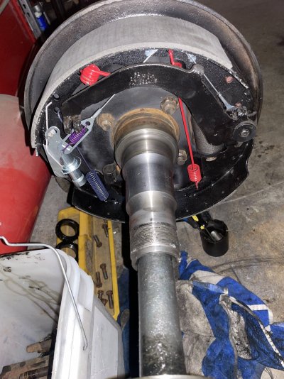

I put a new U joint in. I jacked it up to spin everything just to make sure everything is good. The passenger side nut that holds the hub/spindle on backed off and absolutely destroyed one of the bearings!!! I have no idea what I did wrong. I torqued it down and backed it off a few clicks like the book said. So now I’ll be pulling the other side apart as well to make sure it’s safe. Then new bearings on the passenger side and I’ll drain all the fluid and stuff. Im very happy that I jacked it up before driving anywhere.

After further investigation it absolutely destroyed the passenger spindle. Pretty pissed off at myself for not catching it sooner. I think my best option is swapping the guts out of this axle into my old one.
Bummer. Any other clues as to what could have caused the issue. You don't want to repeat that catastrophe.
