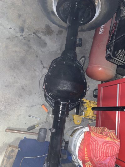

Good evening/morning/afternoon. Whatever it is for you goons. Today I drove up to Sonora, about 2 hours from me, and bought a sterling 10.25 from a really cool guy who decided he’d sell it to me for like half of what he was wanting. Anyways, truck did awesome besides some nice vibrations from the rear end. My plan is to, at some point, either do coils or an rsk and newer super duty axles. But that’s down the road. So I figured I’d just throw another rear end in it while I do other crap.

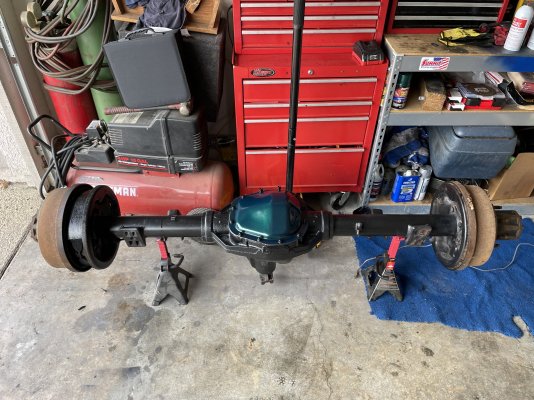

Got everything cleaned up. Took the cover off and found that the gears look fantastic. Got some seals and stuff coming now and we should be good. For a long time I’ve wanted to do disc brakes on the rear but I’ve read alot of mixed emotions so I guess I’ll just stick with drums.
