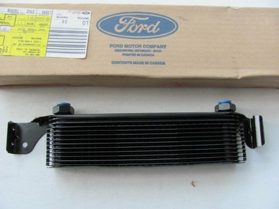

Huh, I guess Ford way over-produced the transmission coolers for 1980-85 vans, because you can still get them new:
It's about 11x2.75x1.5" as the seller shows with a tape measure.
Comparing that to a similar dimension Hayden HD-cool #776 shown below (it's slightly larger, 12x4.3x1.7) the factory cooler is probably rated around 11k-12k GVW. The GVWR of this RV is 11,000 according to the Ford factory VIN sticker, and 11,700 according to the motorhome plate, so that cooler was meant to be the motorhome weight and nothing more (no towing). That factory cooler could easily have been undersized for towing in the mountains, like I was doing. Of course, that doesn't count any radiator cooling as well.
Gonna be putting a cooler rated for around 20k so it should be more than enough cooling.
Almost considering the one below though, rated at 29k. RockAuto has it for $46 less than elsewhere, for some reason. I guess they don't sell many so the inventory has been sitting there for a while so they want it cleared out. It's not marked as closeout/30 day warranty, so I dunno. It's just under $100 (including $17 for faster 3 day DHL shipping) instead of $132 with free, slow shipping elsewhere. 29k GVW might be overkill, but the trans wouldn't die from heat (unless it clogs), that's for sure. With it connected to the radiator, I doubt it'll ever be too cold either, since the IDI runs pretty warm (usually ~180F minimum) so it would be getting some heat from that.
This is the one I was gonna put. It costs 3/4 of the one above and isn't considered as heavy duty:
I hate to blow another $100 right now for a cooler but.... I'd rather blow the $100 now, rather than blow the ~$2000 transmission rebuild.
15,051
14,149
More protection for your major vehicle parts isn't expensive, it's just worth it. I'd say that the factory cooler was made to be just adequate in most "normal" situations. Not what you've been doing. I don't think that you would ever regret the biggest cooler.

I agree. I placed the order for the #779 just now. I just double checked that it'll fit in the space and it will, with room to spare.
