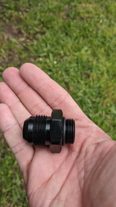

The cooler just got here. Walking to Napa to get adapter fittings. It has huge connections.

Eh, Napa had nothing that big. Didn't bother trying other parts retailers. Thankfully, I found 7/8-14 o-ring (10AN) to 3/8" hose barb fittings on Amazon for $14/each with free delivery tomorrow (due to the free Prime trial). It was that or hop on the bus and try a local shop 7.5 miles away that the Napa clerk suggested, and hope they had something to adapt.
The cooler uses 7/8-14 o-ring (10AN), and the adapter fitting shown in my hand in the post above is 10AN X 37 degree JIC male flare. So, I can toss those fittings in the misc parts box and go directly from the cooler to 3/8" hose.
EDIT: Well heck I found aluminum ones for $9.44/each, Thursday delivery. I ordered a pair of them too. It's free returns, and I am waiting on the GV order to come still, so I'll probably return the $14/each ones since it's free returns. Never hurts to have spares in case one comes damaged or missing. $10 cheaper for the pair, every dollar counts right now. It's on credit, so waiting 7-10 days for a refund is no big deal.
