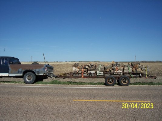

2000 mile trip in 1990 F250 with 2,400 lbs in bed?
15,023
14,120
285/75R16E is usually 3750# rated and fits nicely on a 16x7 wheel.
Off subject, but that's nice to know. For some reason I was thinking that they needed to be on 8" rims.
I have a standard thing that I do whenever towing or carrying a heavy load and that is whenever I stop, in addition to checking my strap tensions I'll feel all of the truck and trailer spindle hubs for temps, and place the upper sides of my fingers against the sidewalls on all of the tires.
I do the same thing if I'm hauling heavy.
Also, whenever towing / hauling heavy, I'll always inflate my tires to maximum recommendation inflation in order to minimize heat buildup due to sidewall flexing.
Oops. I'm not the best at that part. I had these 12 ply tires at only 35 PSI the last time that I had checked them before this. I compensated by only driving 60-62 MPH. This firewood was green and I estimated it at 8,000-9,000 lbs. I know that it was quite a bit heavier than the '91 F250, Ex cab, 4X4 with a 7.3 that I had hauled right after this. I did only have about 100 miles to go so I didn't mind taking my time.

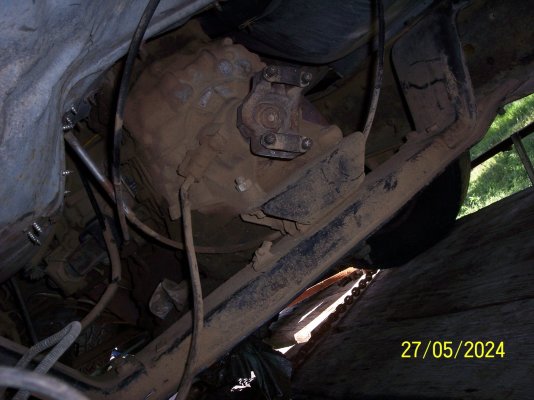

I'd like to source a good, used PTO drive for the passenger side of the ZF5 to run the driveshaft back to the dump bed.
I have one of those. I don't see it on the driver's side in this picture (this is the only picture that I took after getting the parts truck back)so it must be on the passenger's side. I'll have to look for farther details. DM me if you want to talk about it.

How bout a hydraulic drive off the zf's driver drop, back to a remote gearbox drive for the dump bed drive?
That's a good option to keep in the back of my mind as an alternative approach. If I stick with the passenger side PTO drive on the ZF5, all that I should have to fabricate is a somewhat longer drive shaft. This is probably my easiest method.
I'll definitely DM you about it (and thank you for mentioning it). You probably know more about this than I do.... but as I understand, I need to pull the side plate off of the transmission and count the teeth on the gear inside to make sure that they are a match for the model number of the PTO?
I wouldn't know what it's like to tow a load in excess of the trailers axle rating for 100 miles..... Note - the 6.4 F450 (not shown) pulled it just fine, and I too took my time.
I have no idea about that. I know very few specifics about PTOs. It just happened to be on a parts truck (part truck?) that I picked up a couple of years ago. It's a 1989 FSuperduty that used to be a roll back. All I got was from the back of the cab forward.
I also happen to have a belt driver hydraulic pump that mounts to a IDI with V belts that I forgot about.
