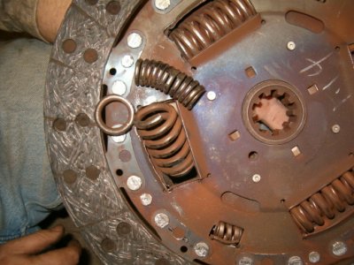

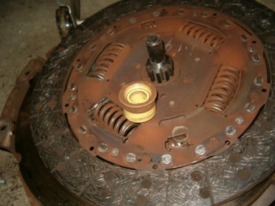

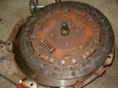

Everthing was fine till I stopped at a light......went to put in gear and when I eased up on the clutch....SH-REEK :eek: Then was hard to shift.......
Got home and 2 hrs later.....here's the pics -cuss :puke:

I spoke with someone at South Bend and have emailed the rest of the pics to them....:popcorn :backoff :popcorn
Chit, when both the other dual mass f/w crapped out after close to 175 k mi,{ in my '90 IDI and the first one in the PSD} they didn't look half as bad as that :puke: not even the one that busted my case cookoo .... :popcorn

George, that's no fun :(
What's the doohickey that looks like a splined shaft in the first two pics? Is that an alignment tool like what you get with LuK clutches, or did the input shaft break? :shocked:
Yea, Tim it's the alignment hickydoo LOL I had it set in before I removed the pressure plate to take some of the weight of my poor back while removing the bolts.

Received a call from SB...... ;Sweet
They are taking care of the issue and sending a replacment assy :hail
Their rep asked me to check a few things that could possibly lead to failures like this..... and I am passing them on for others.
Faulty inj firing- I need to change the harness and UVC on the left bank....rb done a couple mos ago.
Inj themselves check out good----just not Beans Stage 1's----YET LOL
Poor case alignment/input shaft play---I don't see any signs of excessive play and the pilot shaft nose looks clean and concentric as the previous DMFW failure did not damage the needle style pilot brg.
South Bend apparently stands behind their products ;Sweet
I was up front and honest regarding the mileage and time since purchase.
