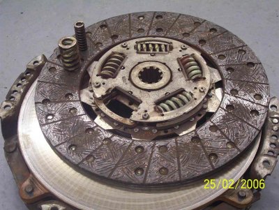

rubberfish
Dec 17, 2003
4,562
11
Langley B.C.
Con O
Will I put another one in???????
Not to sure.
I'm not terribly impressed. :eek:
Ramprat
Inside your OODA
Dec 21, 2003
8,518
31
Me thinks I'm going to rule out south bend clutches :eek: :eek: :eek:
rubberfish
Dec 17, 2003
4,562
11
Langley B.C.
Well, thumbs up to Peter for his customer service.
And to Harry from PDR as well. I stopped in at Piers,
explained to Harry what happened. He gave Peter a
call, and presto, somehow I got upsold to a con O fe
using the credit for the con O to pay for a big
chunck of the O fe. :thumbsup: :thumbsup:
I like when a story has a happy ending. ;Sweet ;Sweet
