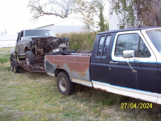

.OH that is this month..or did he mean last Oct...?
It might have been this month. When I hauled off what was left of Scrappy last May, It was $100/ton.
Dang, the 14" tires are getting harder to find. Cooper I guess quit making them which I usually
use, and said Falcon is probably only one his Distributer carries.
185/70R/14 and has a 80K mile warranty.
You might have to resort to buying them online and having them mounted.
Picture of the end of Scrappy for reference.

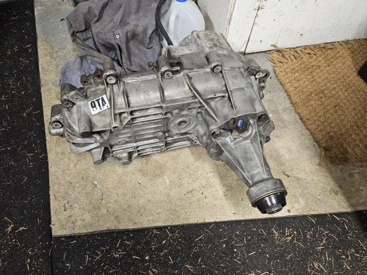

Not today, but over the past two weeks I've pulled the trans and t-case for a rebuild. I've never done either before, so it's been quite the learning experience! Fun, but long, too.
I've owned this pickup for 18 years and 1st, 3rd and reverse syncros were all pretty washed when I got it. Thank God for Redline MTL, because it's some amazing 5-speed juice. (In fact I assumed 1st and R weren't synchronized all this time because they always chattered).
Pictures of the guts:
I painted my  homemade custom downpipe:

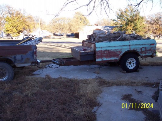

I took off of work early today. I drove over to my garage. I put together me harbor Freight cherry picker, which took ENTIRELY too long for some reason. Then I hooked onto my trailer to bring the load of firewood back home. Finally, I took my folding ladder out of the bed and cleaned out the guttering over my back door before it starts raining tonight. I've been lazy enough that I didn't even unload the trailer this summer. In fact, I'm so lazy that I just leave my Halloween decorations laying around the house all year long.
