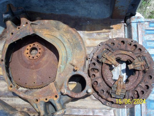

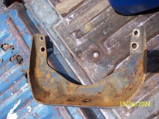

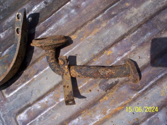

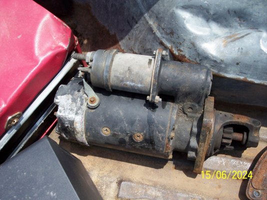

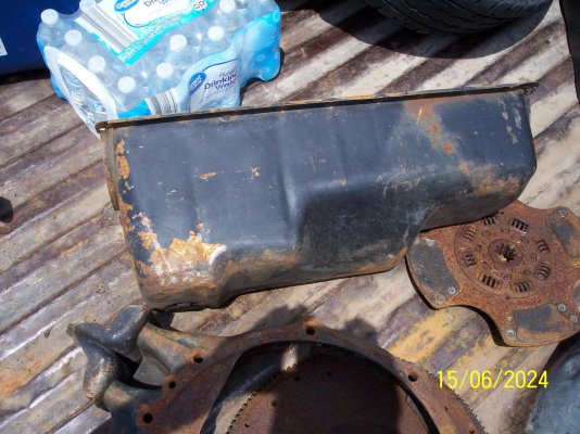

I went treasure hunting today. No these aren't all clean and pretty, but some Evapo Rust will take care of that. These are parts to put an IDI in an International. I didn't get all of the parts though. I'm missing the oil dipstick, exhaust manifold (s?), oil cooler, and CDR parts, but it's all the guy had. On the way back, the long way, I stopped and sold the F Superduty rims and tires to Kansas IDI. Then I stopped in Abilene, KS to see an old school buddy. We ate a late lunch at a nice little bar and grill that I hadn't heard of before. The worst part of the day was on the way back. My truck started having trouble holding speed on hills and it wouldn't even try by the time that I got home. I'm pretty sure that it's fuel relate. While the truck was struggling on hills, I could floor the throttle and wouldn't see smoke of any color out of the back of the truck. I'm hoping that it's a fuel filter. Maybe I got some bad fuel somewhere? I guess I'll check that out tomorrow, as if I didn't have enough to do already.

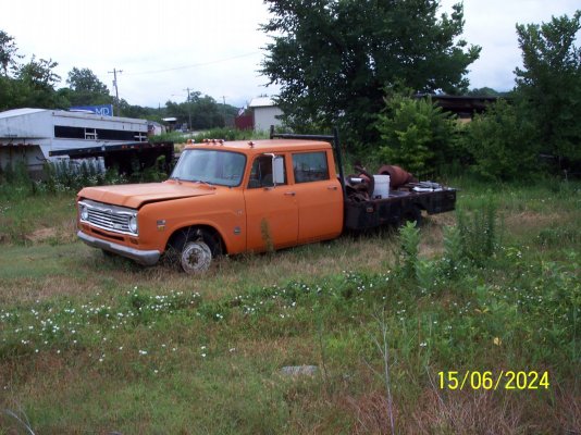

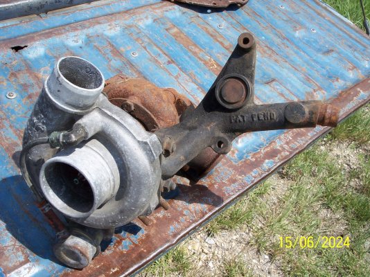

On the way there, I saw this cool old truck. I also bought a bonus piece. A Factory Turbo. It also isn't the cleanest, but the vanes all look good, they spin, there's almost no side to side movement, and I couldn't see any in and out movement so it should be good with some cleaning.

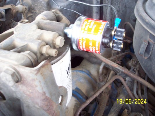

I installed my fuel pressure gauge to see if that was my issue with lack of power while climbing hills at highway speed. Now this is a Glow Shift so I'm not claiming that the readings are 100% accurate, but between the readings and the drivablilty issues, I feel that they are pretty close. At idle, it was showing 1 PSI. The most that I got the gauge to read was about 1.5 PSI. At highway speeds, on somewhat flat ground, it was back too 1 PSI. Going up hills that weren't nearly as tall as I was on last Saturday, it was pretty easy to bottom out the gauge at 0 PSI. Accurate or not, I believe that my lift pump is going out. That would explain the lack of power and also lack of smoke out the exhaust when I floored the throttle while losing speed going up hills. Needless to say that after I got home, I now have a Holley blue on order. This seemed like a pretty good spot for the sender for the gauge.
